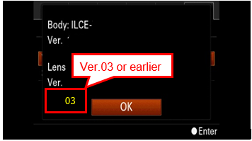

Check the System Software Version of Your Lens
Follow the instructions below to check the lens system software version:
  1. Select MenuSetupSetup OptionVersion.
  2. The lens system software version is displayed.
    Bemærk:
    • If the system software version is Ver.03 or earlier, the update is required.

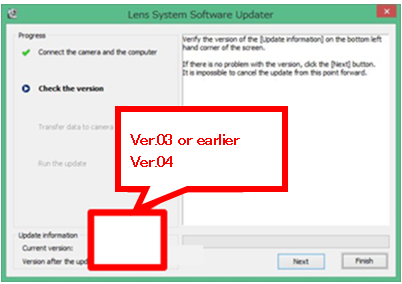

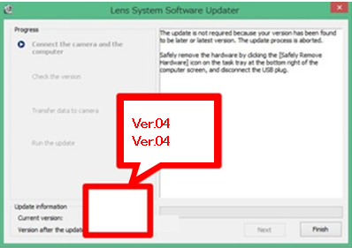

    7. Click Next on the Lens System Software Updater. The current version and the version after the update appear on the lower left part of the screen. If the current lens system software version is Ver.04, the update is not required. In this case:
      1. Stop the USB connection and click Finish.
      2. Turn off the camera.
      3. Remove the battery pack and/or the AC adaptor.
      4. Reinsert the battery or reconnect the AC adaptor.
      5. Turn on the camera.
      • An update is required
        The [Current Version] on the lower left of the screen is showing 03 or earlier, and the [Version after the update] is showing 04.
      • An update is not required
        The [Current Version] and the [Version after the update] on the lower left of the screen are showing 04.
    8. Confirm the Current version is Ver.03 or earlier, then click Next. The data is transferred to the camera (approximately 5 seconds).

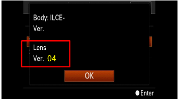

    Step 2: Confirm the Lens System Software Version Is Ver.04
    1. On the camera, select MenuSetupSetup OptionVersion.
      The version will be displayed in the center of the screen.
