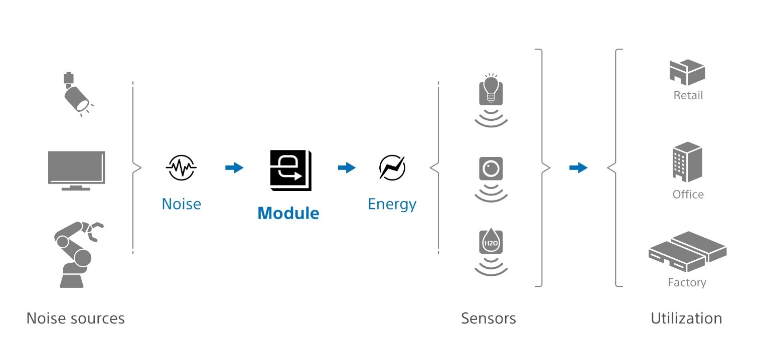

Energy harvesting framework using electromagnetic wave noise

Energy harvesting is a tecnology that is expected to contribute to both the development of IoT and the sustainability of the global environment, with research being carried out mainly in fields such as electrical waves, light, heat, and vibration. SSS’s new technology is the energy harvesting technology to generate power utilizing the electromagnetic wave noise that all electrical equipment generates.

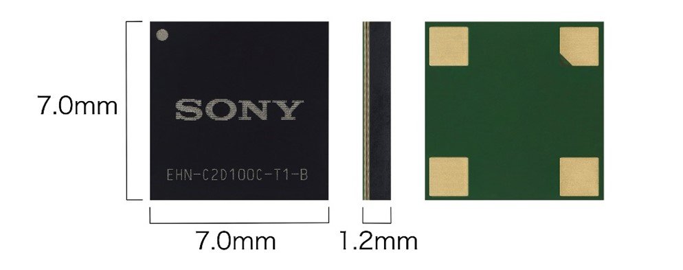

Based on antenna technology created during tuner development at SSS, this new module uses the metal parts of electronic devices that serve as the source of electromagnetic wave noise as part of an antenna and employs a rectifier circuit*2 with enhanced electricity conversion efficiency, for a highly original structure. This allows it to convert electromagnetic wave noise in a range of several Hz to 100 MHz into electrical energy and supply power to low-power consumption IoT sensors and communications equipment, or to charge batteries, despite its compact size. This is the industry’s first*3 energy harvesting technology based on this method that achieves highly efficient power generation. By efficiently utilizing previously ignored electromagnetic wave noise as a new power source, it enables a stable power supply for equipment.
The minimal number of constituent components used in the module yields a compact design that allows for greater freedom of installation. Also, as long as electronic devices are powered, energy can be harvested even while they are not in active use, making this technology promising in a wide variety of usage situations such as factories, offices, stores, and homes, both indoors and outdoors.
Developed module (size: 7 mm square)
